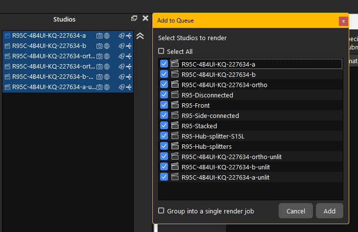

Hey all! Doing a large project of relabeling products, so we set up a template and are just duplicating the project, importing new models and replacing labels, and rendering out whatever images. We have some multi materials and a mix of model sets, so we are using studios to set everything for render. Well, for this product, I duplicated the .bip file, renamed it, opened and made all the changes. I deleted handful of studios that I didn’t need, so there were only 6 studios that I needed to render. But when I went into the queue to add the 6 studios, a handful from the previous project that I had already deleted popped up that I could choose! You can see from the screenshot that on the left are the studios that are in the project, and the right shows the studios in the render queue that I can choose from! Some where in the project file they aren’t being cleared out. And yep I saved the file before going to the queue to add the studios, and yep I restarted KS to try to give it a fresh start. just super odd, and everything rendered properly, I just didn’t select the studios I didn’t need.
Just super odd to have the studios still in the project somewhere even though I deleted them.
I’ve the idea same happens with Model Sets sometimes. It’s just hard to pinpoint when it happens. Think you would help the developers if you could share your files so they can examine it but not sure if you’re able to.
Currently I’ve the feeling the renaming of items is a possible cause. It’s like if you rename an item/model set/mesh the old name is still somewhere in the file and can appear again if you organise things or import other models where that same name exists.
Again, really hard to figure out what’s happening or supply clear instructions on how te replicate the issue.
